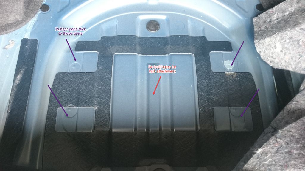

- Remove the felt and you now have a bare trunk. This is what mine looked like and notice it has no bolt holes for attaching the center hub clamp of the spare wheel.

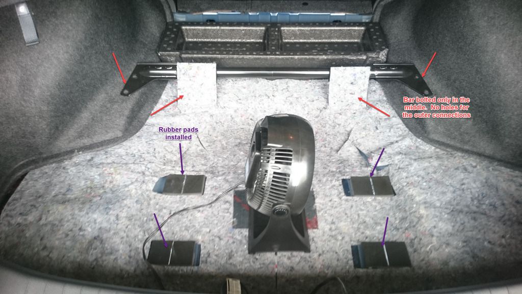

- Install the rubber pads as shown (note that I received 6 rubber pads - 4 thinner ones with white lines and 2 that were thicker and did not have lines, use the 4 thinner ones with white lines.)

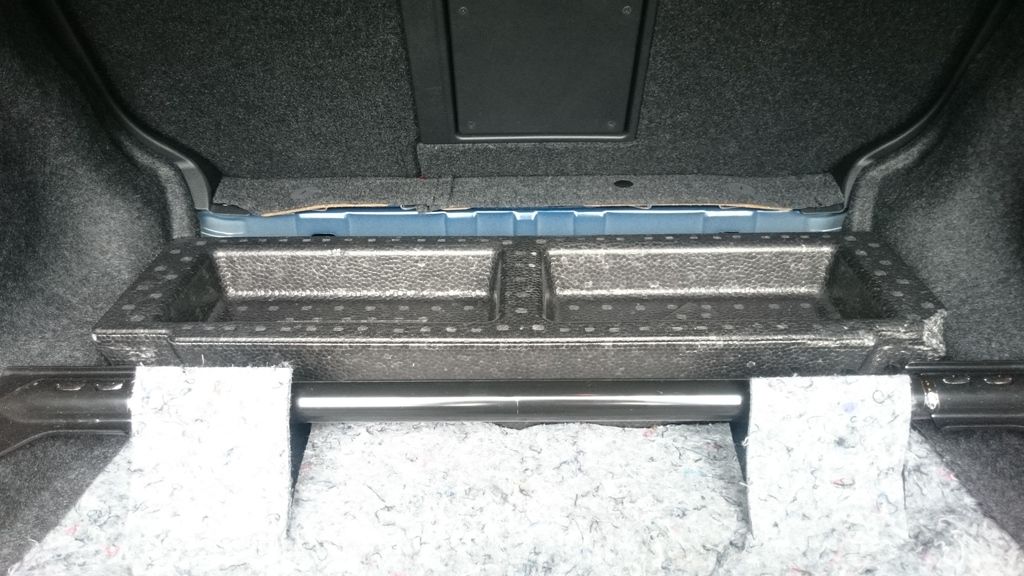

- Bolt the cross bar in using only the middle 4 bolt holes. My car did not have holes in the trunk for the outer 4 bolt holes. You'll see below that I just laid the bar on top of the left and right trim pieces and bolted it with the inner 4 holes. A true spare trunk would have those outer holes and different trim pieces.

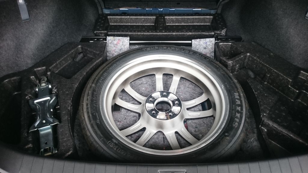

- Lay in the front foam insert
- Lay in the left and right foam inserts.
- Lay the spare tire/wheel in upside down.

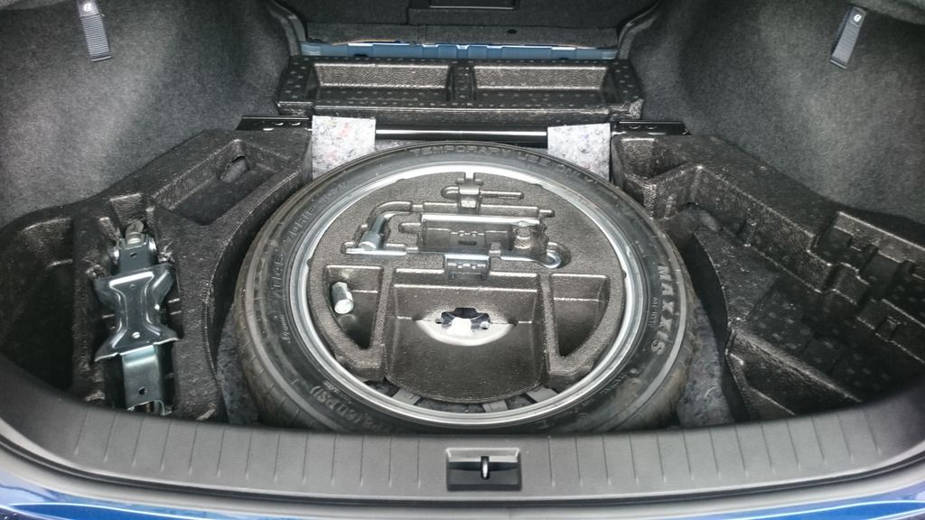

- Lay in the foam insert inside the wheel
- Everything should be level across all those surfaces.

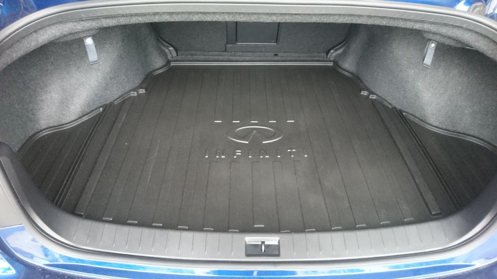

- Install the trunk mats and you're done!
You lose about 4 inches of depth. A good way to judge this is notice how the front bump between the trunk floor and the back seat is now level with the trunk mat. Also after driving around this way, the spare wheel has not budged at all. It is very secure.
