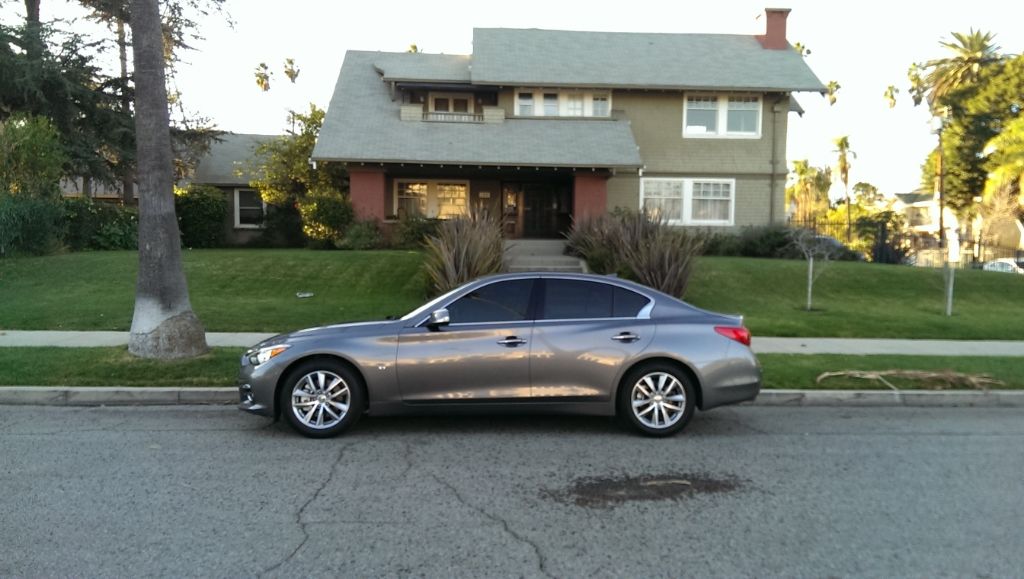

Here is before

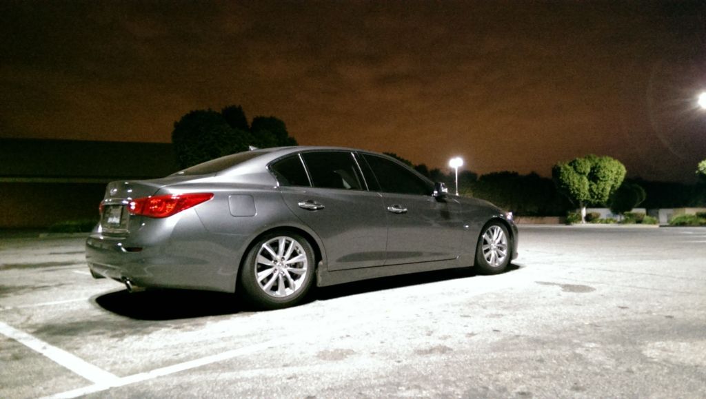

After
will try to get some measurements today. Now time for wheels

notice any difference in the handling??
So low, I love it!
time for wheels
haven't really had a chance to drive hard. car is laded with tools. i did notice less body roll though

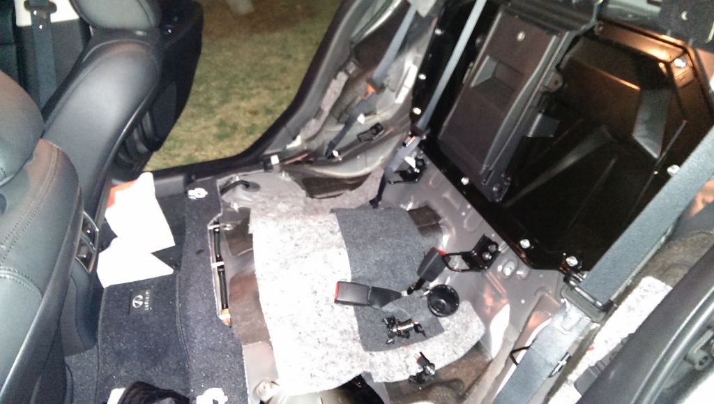

btw this is what you have to look forward to for the rear install. not hard, just time consuming

Looking good bro! Throw in some spacers for now! Hehe! :D
Looks so nice...awd or rwd? I haven't been keeping up with the suspension options for awd. :(
Nice! Glad to see another Q on BC coilovers.
I'm trying to save for wheels and coilovers at the same time. If I keep seeing nice drops, I'll have to pull the trigger on the coilovers before the wheels.

you have to take out the back seats for install :confused: ? did anyone manage to do it without taking it out? I'm really itching to pick this up as well... though friends are convincing me to build towards the VIP look :cool: so if i decide on that i might toss in the cash for some bags ;)
You have to take odd the seats to get access to the three bolts that hold the rear suspension in place. Not hard just time conauming.
