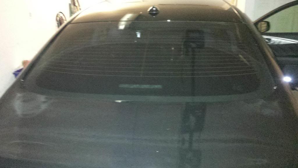

second, I've done window tint with 20% transparency

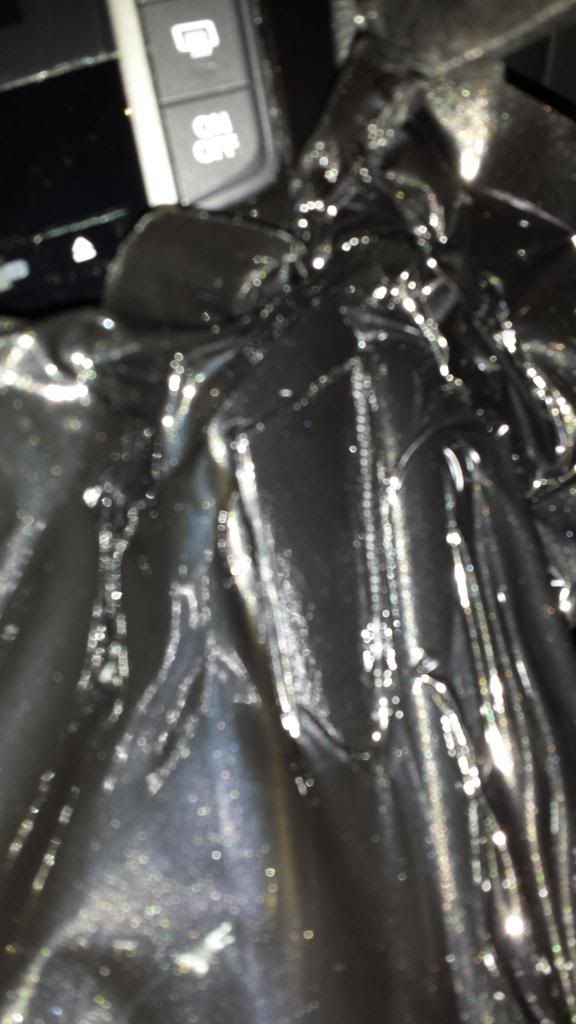

about to start the one of the larger trim which I first cleaned with clear rubbing alcohol to get rid of stains and any other contamination and then used a 50/50 water soap solution as lubricant for easy application and to remove air bubbles with ease
used hair dryer to stretch it and make it fit smooth, did try it with a heat gun, got to hot and while stretching the wrap, the vinyl will start to tear up and get holes and the hair dryer had just the right amount of heat to stretch it without the wrap tearing up
this corner was the hardest part to stretch and make it stay in spot, had to heat it up and place a wet rag on top of the trim to cool down the wrap and make the glue adhere to the trim
stretched this out nicely to make it fit smoothly

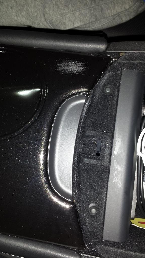

for the cupholder, I made the cut in the middle where there was open space and got ride of the excess wrap to make it easy to cut. I did not use the scalpel for the cupholder, and instead i used my nails and that was to make sure I don't damage any of the other trim and my nails cut through the vinyl while it was still soft from the heat of the hairdryer and with the contour of my nails, the cut came out smooth and the the edges also got rounded down for a clean fit
this edge was quite hard too because of the multiple angles and needed to reheat and readjust over and over again to get a clean fit. Currently there is a bit of rough edges still but no one will notice it
the finish product of the largest trim
