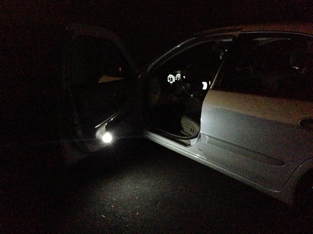

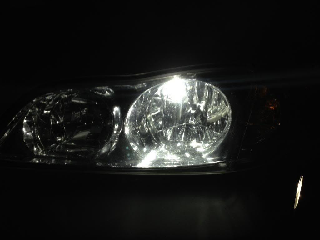

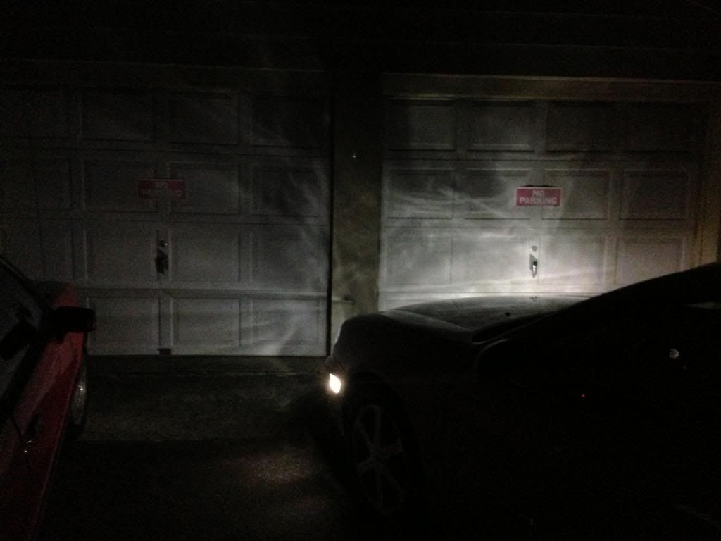

Here's how some of them look in my I30. I know they are bad quality photos, but they give you an idea of how bright they are and how they look. In these they are in my dome light, map light, courtesy lights, clearance lights (inside the headlight), and front side markers.
