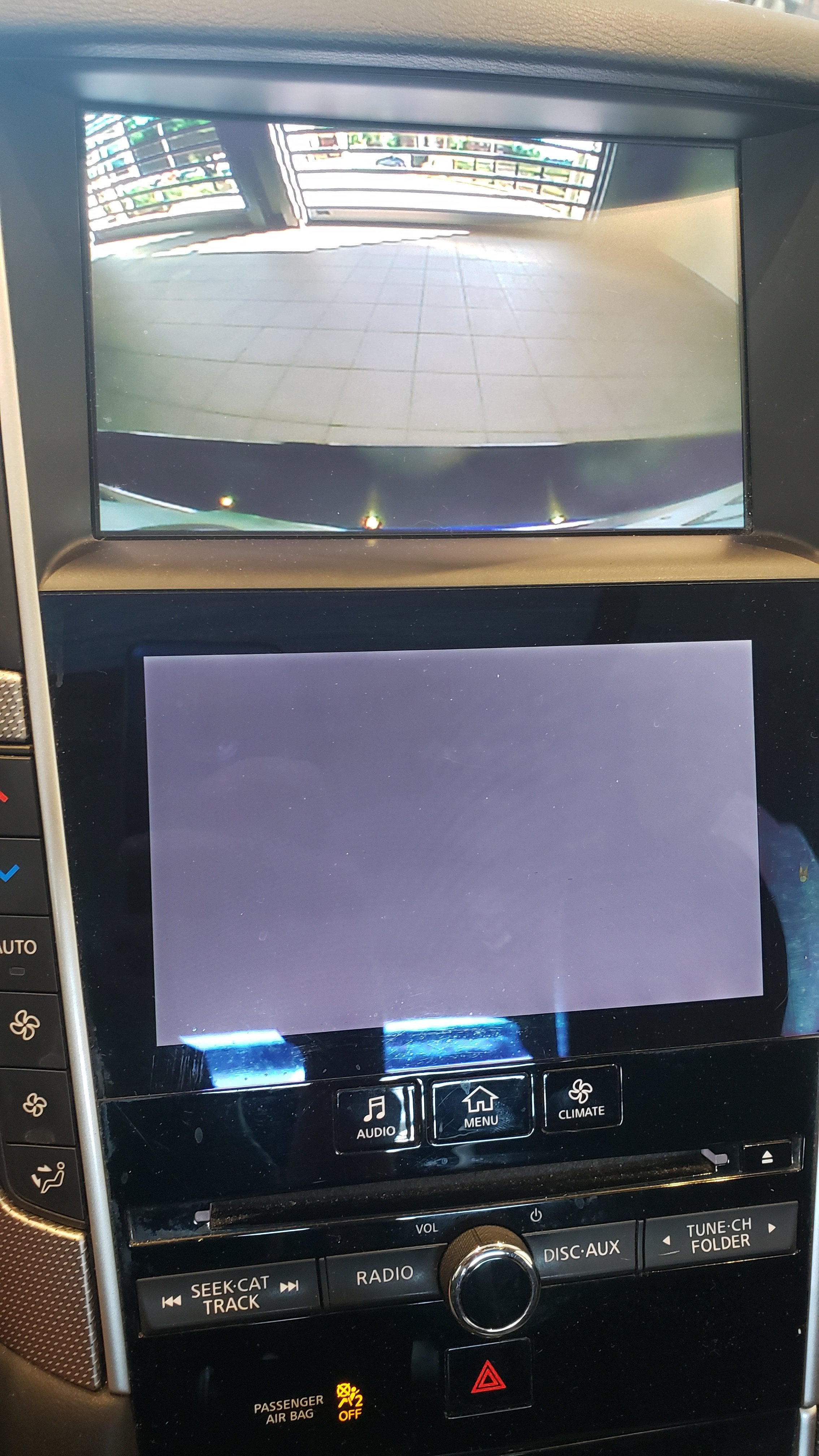

I'm purchasing a 2015 Q50 base AWD sedan and neither the top nor bottom screen works correctly. The top one works SOMETIMES with the backup camera (see pic), but the bottom one never works. Each has the back lit glow but neither display shows text.
