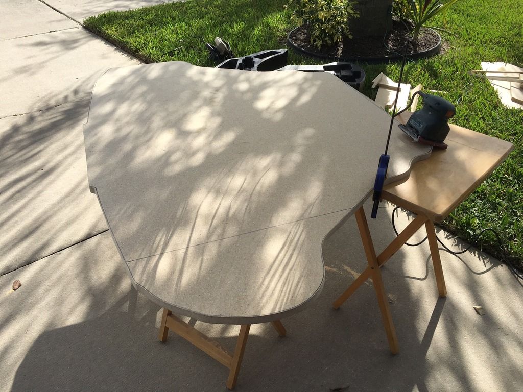

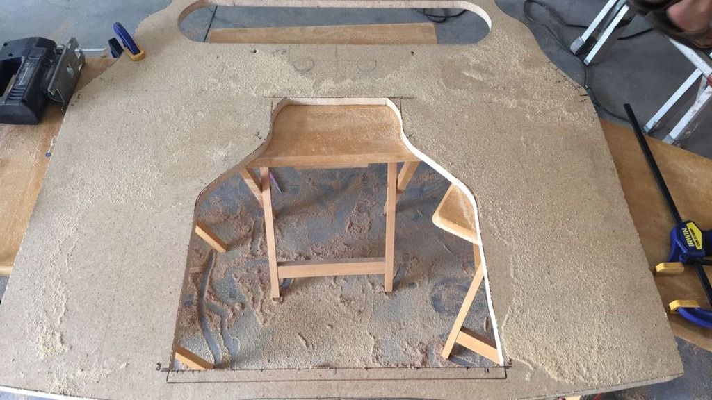

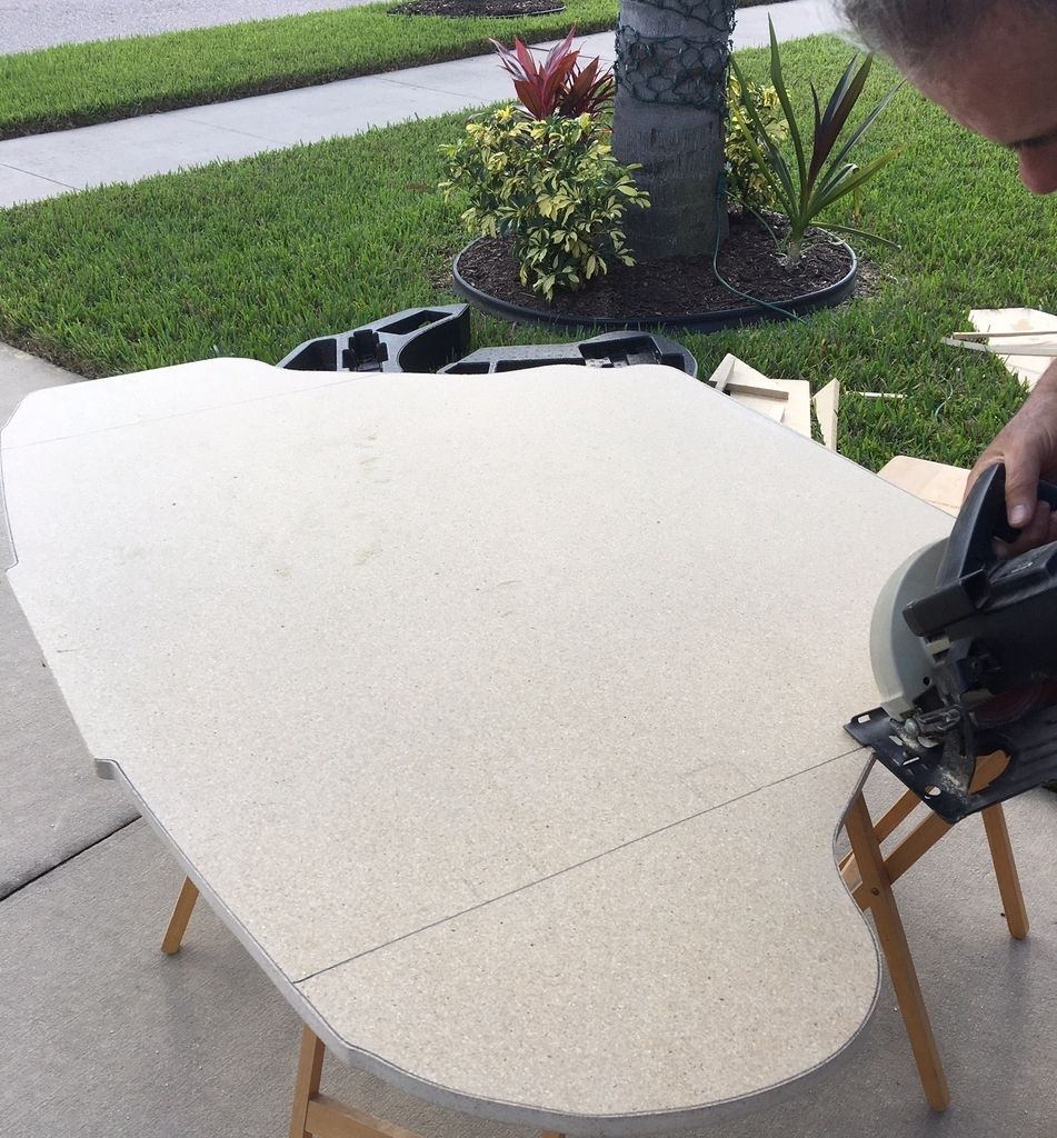

All the parts and pieces have not arrived, but had to take advantage of the three day weekend at home and start cutting the mdf board to start the trunk setup.
The top mdf cover will have (4) 45 degree cuts to allow me to access everything in the wheel well by only taking out one piece of mdf. This same piece will also house the plexi.

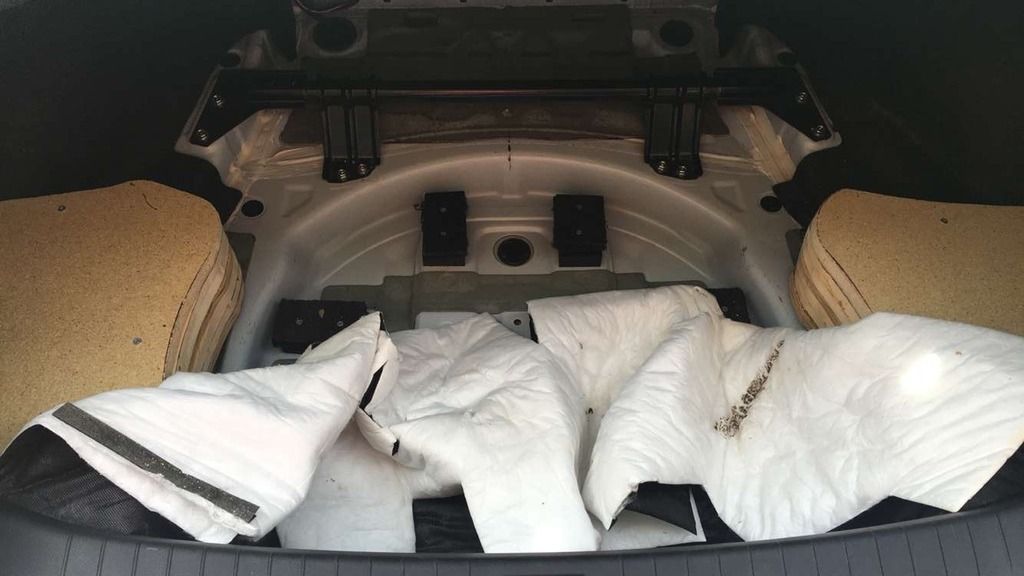

In the first picture here there's a black metal bar that runs across the bottom of the trunk. Did you just unscrew that and take it out? I've got the spare tire package as well and didn't want it at all but it came with the car. I thought it would just be easy to take the tire and extra foam inserts out and it would be just like a car without that package but then the dealer pointed out the metal bar. They seemed reluctant to just take it out and I wasn't sure if it could just be removed or if something was attached under the trunk that would get messed up if I removed it. Did you find anything out about this or just take it out and no problems? Your trunk build looks great so far though. Once winter is over i will be doing a similar build but just for audio. I would love to do the air setup but it seems very involved and expensive.

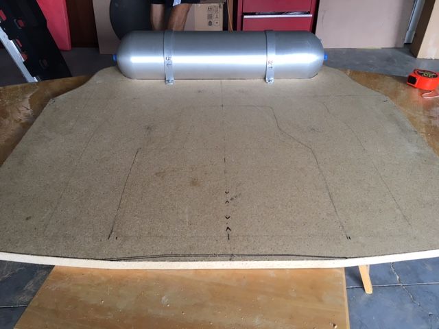

@Fasteswarning & @houm_wa not sure if you two are being serious or not, but this look can be accomplished in two ways. Either with coilovers or with an air ride system. The compressors allow me to supply air to my 5 gallon tank which will store the air that is then fed through to the bags.
I am running two compressors not only to fill up the tank faster but for the benefit that of the unlikely event that a compressor fails, that I wont be left without any means to fill the air tank.
You can unscrew if it you would like to and take it out, but I am not sure what kind of support /brace it provides to the car or if any at that. The spare tire is standard in all cars, if you want to remove the foam you will lose the support underneath for the cover you have on top. I am keeping the foam because i want some of the OEM pieces used as a support to my mdf that I will be laying on top.
But if you need the room for your audio system you plan on using then its easy to remove it all. Good luck with your setup, post some pictures when you start the progress.

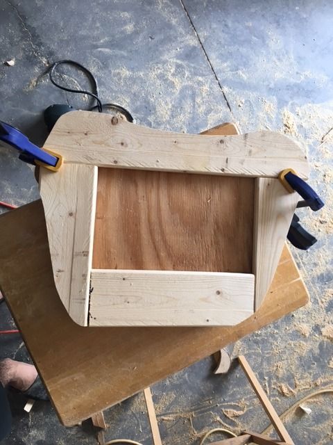

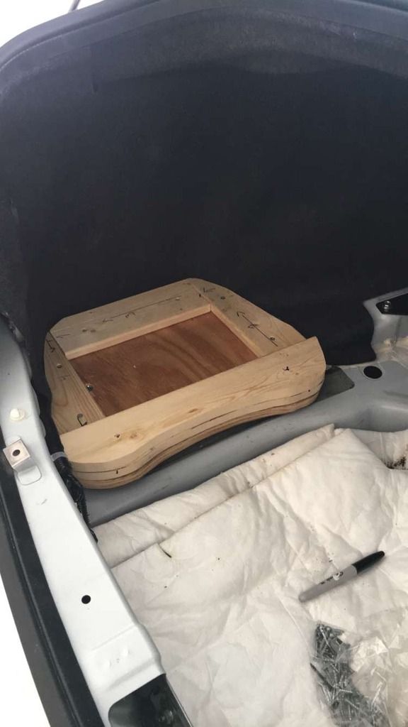

In order to get the top board sitting the way I wanted and to be secure in the back of the trunk I had to start stacking wood like Sadistic Iron Werks and rid the foam from the trunk!
